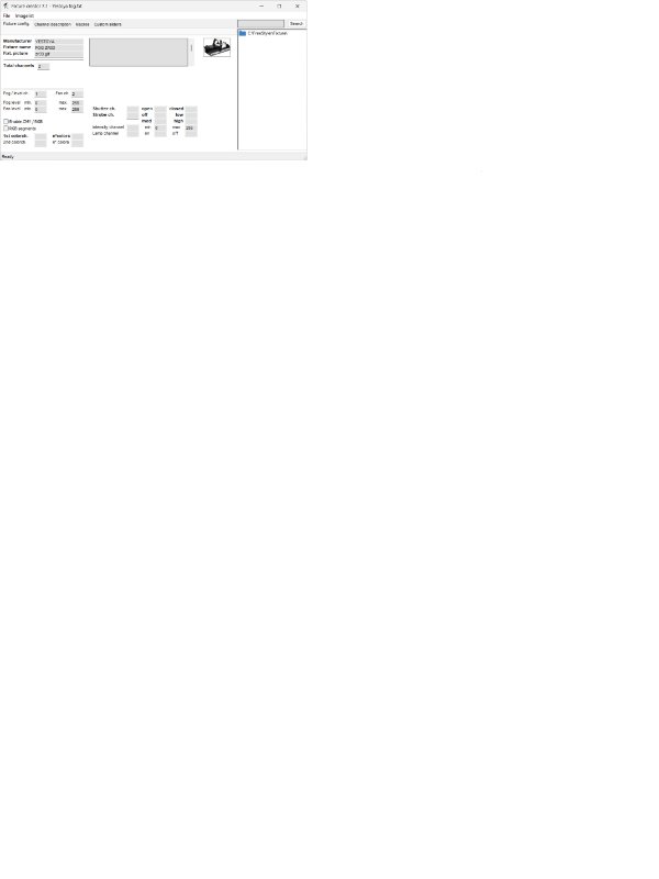

popu
- Posts: 3
- Joined: 11 Jan 2025, 09:51
- FreeStyler Version: 4.1.6
Re: Button "Fogger control" don't work
Thanks you, but I already try your suggestion, when I change fog machine slider, the show output react well, but if I change from fog panel, the show output cannot react at all. I use from fog ZR-33, from the fixture library.
- (10.78 KiB) Not downloaded yet
hazer trial.mp4- (763.09 KiB) Downloaded 623 times
O Now I see the problem, Thanks for your help sir smp_qui_bug, If I change the slider in the fog panel, it can't effect the output, but I must to press the button FOG in the fog Panel. Thank you all, Problem solved.
