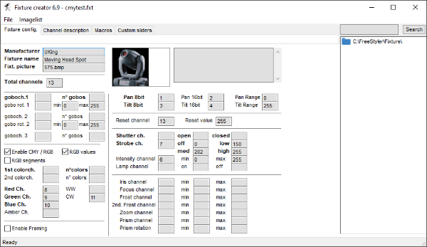

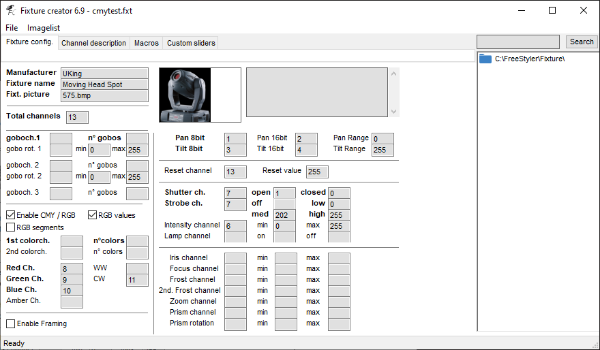

I really hope I am in the right place. Just started to learn Freestyler and DMX512 in general. Bought some cheap moving head spots from Amazon, obviously no native support :) Have the manual and channel map, done a couple of Freestyler tutorials added a new fixture based on existing similar fixture then modified the settings to suit. All went well and most features are working fine. However the "RESET" feature isn't resetting and the strobe feature isn't un-strobing when the slider set to 0 (<150).
I have exported and attached the PFF file if someone would like to take a look and let me know how I have gone wrong? Eager to learn hence taking the long way around and building from scratch. :)

NAILED IT!
So here goes, two new fixtures for you all! Especially useful if you have just bought some cheap lights from Amazon!
UKing 60W RGBW Moving Head Spot
https://www.amazon.co.uk/gp/product/B07 ... UTF8&psc=1

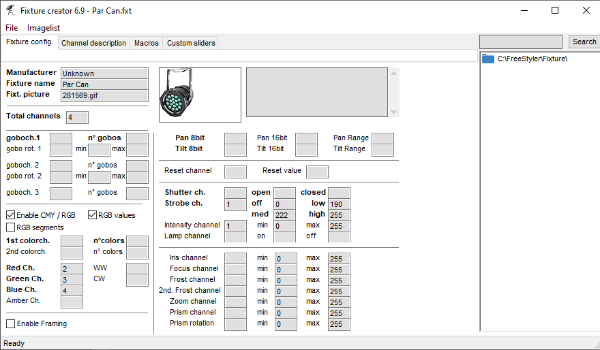

And as a bonus...some cheapo OrangeA RGB Par Cans
https://www.amazon.co.uk/gp/product/B01 ... UTF8&psc=1
