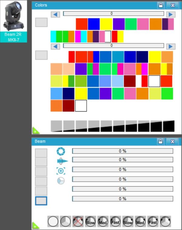

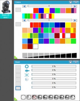

This is my new fixture
I have several questions about your suggestions:
- How to create custom sliders for channel 12 ?
- For channel 17 and 5 what's function is more suitable ?
- How labeled a channel for another function ?
Beam 2R MKII.pff- (309.91 KiB) Downloaded 18 times
Jan_K
- Posts: 1155
- Joined: 04 Jan 2011, 21:57
- FreeStyler Version: Beta
Re: Evolite Beam MK2
Have a look
DamsoC
- Posts: 4
- Joined: 09 May 2020, 16:44
- FreeStyler Version: 3.6.51
Thank you very much for your feedback, I will test this quickly.
