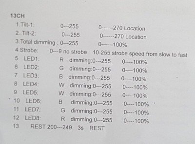

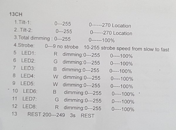

Here is the description from the manual:
Is there an existing fixture file that works with this device?
I found a 7 channel setup, but the channel adresses are different to my manual.
OK, I managed to build a basic setup for the 13 Channel mode. The Channels 5 -12 (LED1-8) are defined as custom sliders. You have to set the device to 13 Channel mode (second menu entry) ...
