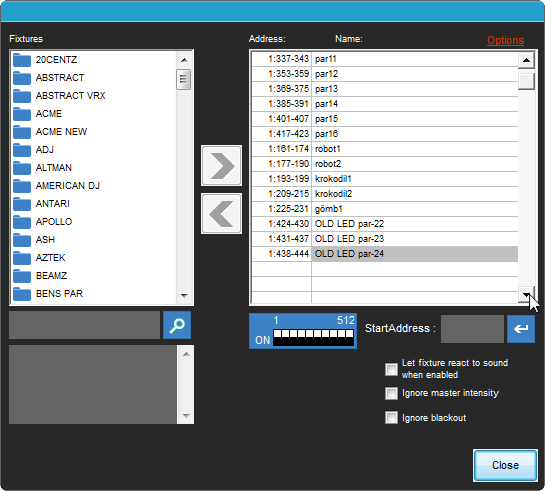

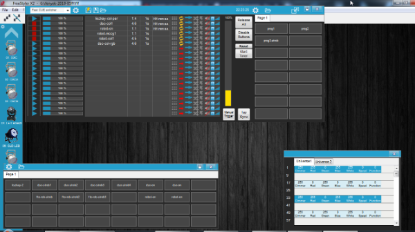

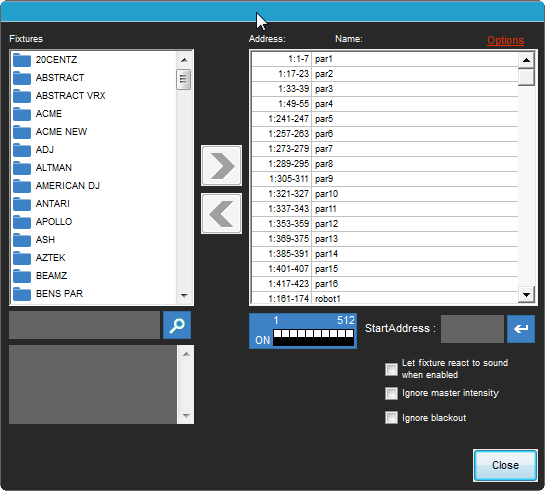

I only used Led par 1-4,and the 2 moving head (we call them robot in Hungary, sorry for it in the video).
I attached the address settings, and some other settings (maybe to solve the problem)
What can I do wrong? Can it be be bug?
It already happened to me, but happened again at a wedding (fortunately before, and i set the moving heads for manual operation, Freestyler used only the led pars)
I made a video:
https://www.youtube.com/watch?v=vDa1wC5MB6w&t=1s

* Please view the 'Show output' window of FreeStyler. Here you can see the actual DMX values being sent to your fixtures. Check if FreeStyler is sending changing values to fixtures, when you think it should not. If that happens, most likely there is a problem in your sequences.
* When the above dmx values are correct and not changing for a certain led par fixture, and you are still seeing the actual fixture to change its light output, then you might have a serious DMX cabling issue.

I don't have the lights at me now, but the output seems that the led pars should work (dim channel at 100)
