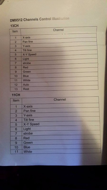

Only came the information that is attached.

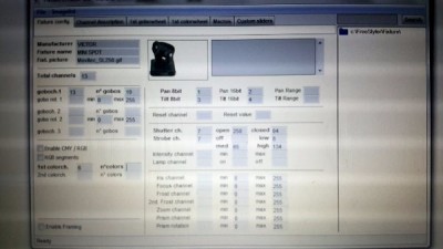

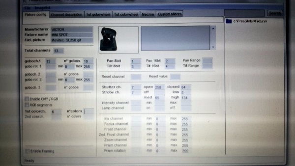

Could anyone help me by sending the fixture creator's screen from this information?
I'm from Brazil, sorry for poor English.
I can not configure this mini bean in fixture creator Topic is solved

Here is a fixture file that should work if you have the fixture setup properly within itself. Using the menu on the fixture itself you must have it set to 13ch mode and also addressed corectly. If the fixture itself is not setup correctly then the DMX will never work properly. The attached file should control all aspects of the fixture but I have no way of testing it.
12 Watt Cree Beam.pff- (4.46 KiB) Downloaded 19 times
