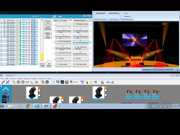

Latest FSX2 release. 3.5.9
I installed this yesterday fresh on another computer.
3D viewer will not start from the FSX2 Icon.
If you start it from the C:\FreeStyler\EasyView.exe it will then start and you can select Art-Net by default. Freestyler will not show up in the DMX options.
The Art-Net interface will run fine from another computer using FSX2 sending Art-net.
I will see if the Microsoft Loop-through Network Protocol will work with this on the same computer and advise.

Re: Issue with SLMEV3D Not working.
I got it working using the Art-Net Microsoft Loop Back Adapter.
I did have issues with the icon in Freestyler X2 running SLMEV. If you click on it you get an error trying to start the SLMEV.
If you run it directly from the magic.exe in the freestyler folder then it will run and you can select art-net.
I will do a tutorial this week on how to install and setup the Art-net and MS Loop Back Adapter.
