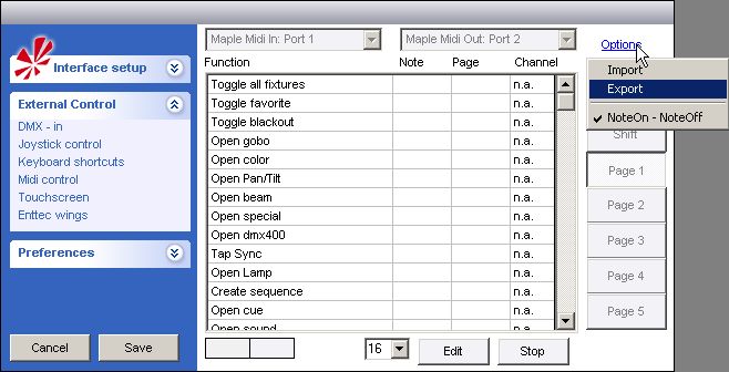

Hello, I have a problem with setting the BCF 2000 and midi pages.
I set the controller to the 4 buttons to toggle MIDI pages.
The first button switch MIDI pages I programmed so that the sliders 1-8 DMX channels directly control 1 to 8
Second button switch MIDI pages I programmed so that the sliders control submastrs 1-5
When I switched to a MIDI DMX speak the values 1-8 that's fine, but when I switched to MIDI 2 to control the value of submasters 1-5,and at the same time as DMX values 1-8

I have set:
1 button switch MIDI pages I programmed so that the sliders 1-8 DMX channels directly control 1 to 8
2 button switch MIDI pages I programmed so that the sliders control submastrs 1 to 5
We expect:
If you switch to a MIDI 1 controlled only the value of DMX 1-8
If you switch to MIDI 2 to control the value Only authorized submasters 1-5
How it works:
If you switch to MIDI 2 to control the value of CURRENT submasters 1-5, and changing the value of DMX channels 1 to 8 (Change in value submasters also controls the DMX values 1-8) This is wrong.

I have tried to reproduce the issue, but i can't. I have double checked your fms file but can't see any problem...
I have to ask you again: do you have any sequences in the submaster which control one or more of channel 1-8? to be sure you should do the test without any sequences in the submaster

Submasters controls a sequence of RGB RARS - DMX 20,25,30 .... . I do not have a single sequence that includes DMX 1-8. That's just weird ...

I seem to remember reading somewhere that the submaster faders control channels 1-20 until they are "used" - that is - until a cue has been loaded and run. Could that be PePu's problem. If he loads a cue full of fixtures that have no intensity channel (there are some in the FreeStyler included fixture files) then I assume that it would not be "used" and the sub faders would continue to control the channels 1-20. Pepu might also have made his own fixtures and not entered an intensity channel. Or my talk bottom out of.
