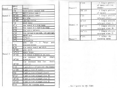

Very new to DMX and this forum but did some reading...here goes...
Got a DMX laser from eBay. Maybe not the best but it seems to work great on sound mode.
I'll include a copy of the manual since the gobos, movement, zoom, etc... don't seem to the same information that fixture creator needs. (the light fixture file)
thank-you so much for any help as to how the values should be inputed and where?
bcondemi
Allowed size of attchment is very small. hopefully someone can just zoom in.
thank-you

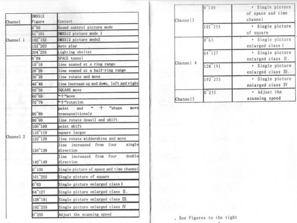

I've just created a fixture for a 20CentZ RED+GREEN laser with the model XXc007 printed on the front. I don't know if this is your unit (probably not) but maybe the fixture file can give you some help to set up yours correctly. The manual included with the DMX values (same as you posted) was severly incorrect at best so this is mostly based on trial and error.
Hope this helps!
Also check out http://www.freestylersupport.com/fsforu ... f=23&t=630 for the .pff file for this fixture.

I asked for this file a while ago and made a primitive one compared to this! Thank-you very much!
