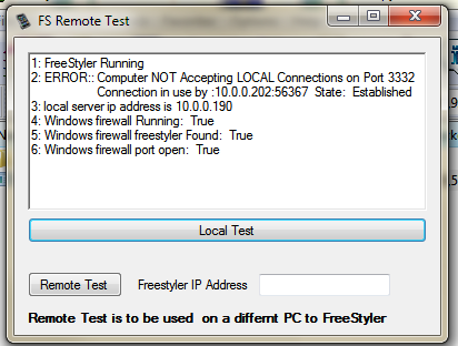

If your having connection issues with IOS or Android remote, post the ouput here for help

Here is my report...

Your problem appears to be server side, have u changed the port fs listens on? Is any thing else using that port? Can you see a remote symbol on the top right in freestyler?

you need to change it back to 3332, currently there is no option for the remote to use a different portJamesLS wrote:How would we change the port FS is listening to?

I have two machines. A desktop and a laptop. Both run Windows 7 Ultimate and both have this as the report.
1: FreeStyler Running
2: Computer Accepting LOCAL Connections on Port 3332
3: local server ip address is 192.168.1.10 <-- Laptop IP ".14 <--- Desktop IP
4: Windows firewall Running: True
5: Windows firewall freestyler Found: True
6: Windows firewall port open: True
My phone is a Galaxy s 2 running Android 4.0.4 with Freestyler Remote Pro.
I can connect to the desktop no problem. However I can not connect to my laptop at all. Even when I set the IP address. Any ideas?

does your laptop have any other security software running?
if so disable it,then in FS check that the remote icon in the top right corner is not showing before you connect if it is right click Disconnect All.
The report shows that both machines are contactable, run the report software on your desktop and type in the laptops ip in the box labeled Freestyler IP Address then press Remote test.
This will test if the laptop is blocking the port externally.
2: ERROR:: Computer NOT Accepting LOCAL Connections on Port 3332
I can see no possibility to change any ports in FS
Error persists even if i disable the Windows-Firewall!
I can see the BT-Icon in FS-Software, my tablet shows"Freestyler BT" in status connected
Please help.
Amnesia

if your running bluetooth then firewall is not the issue.
run the tool without the bluetooth server running, as FS can only accept one connection at a time. although i expect this not to be the problem.
If the app says it is connected, what issue re you having as you havn't said?
3: local server ip address is 192.168.0.25
4: Windows firewall Running: True (----> I'm using Kaspersky Internet Security not the Windows Firewall.)
5: Windows firewall freestyler Found: False
6: Windows firewall port open: False
What can I do to get Freestyler connected and controlled remotely?

Your will need to open port 3332 in both windows and your kaspersky firewalls.

Open port 3332 in both windows and kaspersky firewalls, that's enough for solving the problem ?

Ok, downloaded the diagnostic tool and here are the results:
1.Freestyler Running
2. computer accepting connections on port 3332
3. local ip address is 192.168.1.14
4. Windows Firewall running true
5. Windows Firewall Freestyler Found - False
6. Windows Firewall Port open - False
I saw someone else with the same results and you to;ld them to o[pen the port on the firewall. How do you go about doing that? I have no clue.

http://www.howtogeek.com/112564/how-to- ... -firewall/
Create a new inbound rule.
set as a port rule
set port as tcp 3332
allow connection
select all 3 domains
save
set as a port rule
allow connection
save

Hi Matt,
Ok got everything set and reading correctly on the FS remote test except item #5 which says: Windows Firewall Freestyler found: False. I can't seem to figure out how to get to the setting so that I Windows Firewall can find freestyler. I'm running Windows 8.1 by the way.
