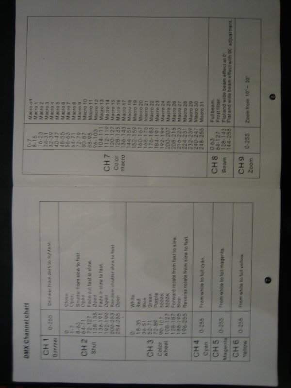

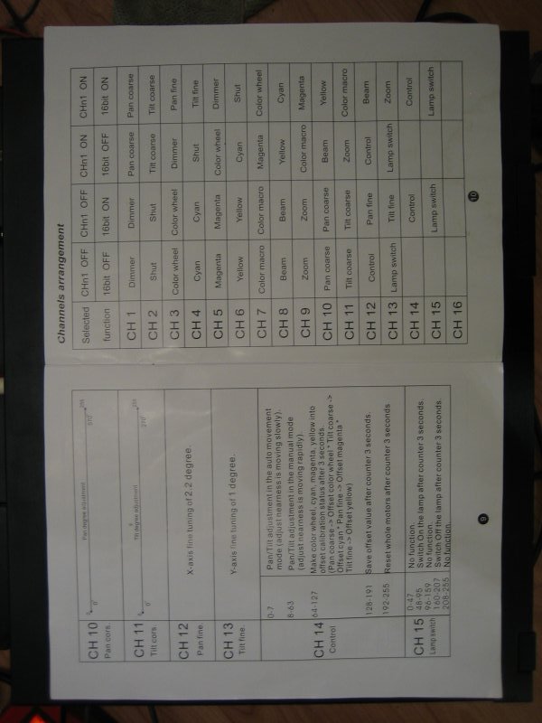

I'm trying to create a fixture for the above mentioned wash, but got stuck. Don't know where to put the "Color macro", "Beam", "Pan/Tilt fine" and "Control" channels. If someone can help and tell me this it would be great, or even better if someone can make the fixture.
Below is included the channel list (not the best possible picture because of the limitations of the site).
Thank you for any help.

Colour Macros are on the 2nd Colorwheel
Fine Pan is the 16Bit in english lol so that was already setup properly
Beam is the frost channel use the frost slider or use the right hand slide out levels.
