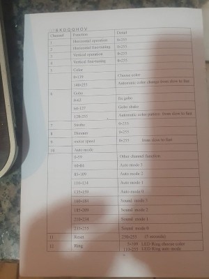

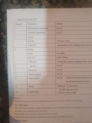

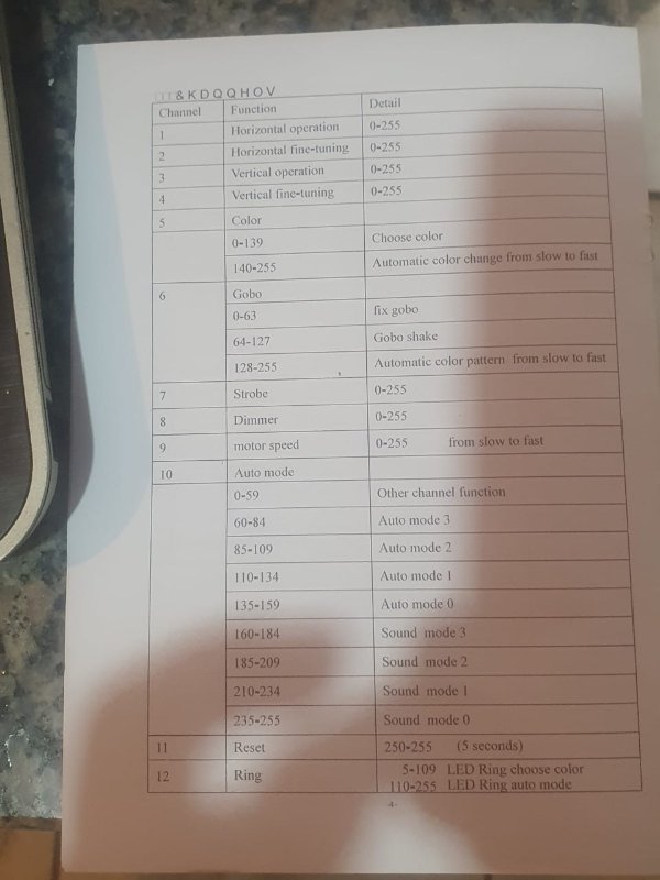

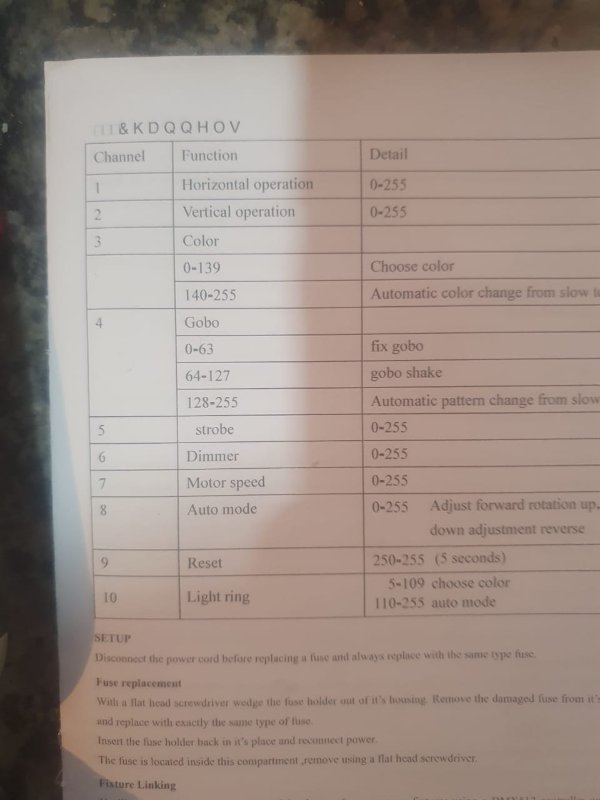

has anyone got file for 9/11 channels as I cant get colours up on mine

Thank you for the link. Unfortunately no DMX information is shown or linked to (which is what I always find with eBay links). I sent an email to the manufacturer requesting a PDF of the user manual. They may or may not reply.
I saw the cover of a user manual in one of the photos. Can you take pictures of each page and upload the pictures? Hopefully there will be DMX information that can be used to create a fixture definition.

U'King provided a partial user manual. Based on the information provided by U'King I created the attached 21 channel fixture for your instrument.
Your feedback is welcome.
Also attached is the PDF of the user manual provided by U'King
Note that, according to the manual, your instrument has 2 sets of RGBW LEDs. The attached fixture uses Freestyler's RGB segments. If you open the Colors window you will see, in the lower left corner, 2 check boxes. Freestyler will send DMX values only to the set(s) of LEDs that are checked.
U-King 50W Double Sides Stage Lighting RGBW LED Beam Moving Head DMX512 DJ Light.pdf- (233.7 KiB) Downloaded 38 times
UKing 50W LED mover 21ch.pff- (6.15 KiB) Downloaded 38 times
