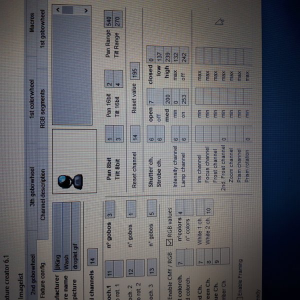

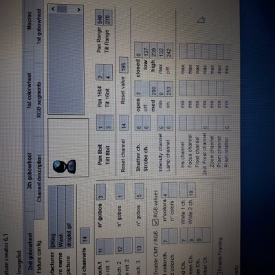

So, here's the set up I have for the light control channel (shutter, strobe, intensity, lamp). Again, thank you for taking the time out to help me.

FYI in the Fixture Creator you can EXPORT the fixture to a file and then attach the export file to a post. This allows us to IMPORT the fixture and look through all of the definitions.
You have the lamp channel defined in your fixture. If you use the lamp channel programming window to turn on your instrument, Freestyler will send a value of 253 across channel 6. If you then tell Freestyler to fade the light, via the intensity window or the standard slider, Freestyler will dim out your light by changing the channel 6 values from 253 to 0 across the time interval of your Sequence. Remember that channel 6 also controls STROBE and thus when Freestyler sends the values 239 to 137 across channel 6 during the fade your light will strobe.

Hey Rod, once again thank you for your patience and your help. I have attached the .pff file as you've requested. Last night I got thinking about that channel 13 and delved a little deeper into it, and ended up creating so gobo's for it.

Glad to see it works!skelly69 wrote: 31 Mar 2019, 00:16 Remco, thank you brutha!!!!! You sir are a gentleman and a scholar!!!! The moving heads no longer strobe when fading out!!!!! A god send!!!! Once again sir, I thank you!!!!
For learning purposes: You entered bad shutter open and close values. (resp: 7 and 0)
Form the tech spec you posted: "channel 6 controls Off - 0 to 7, Master Dimmer - 8 to 134, Strobe from Slow to Fast - 135 to 239 and Open - 240 to 255."
Can be translated to this: Shutter closed: any value from 0...7.
Shutter fully open: 134.
So, the entire shutter/dimming range is from 7...134. Where 7=Off and 134 is fully on.
Anything above 134 and below 240 will set the fixture to strobe mode. 240 and above is also fully on.
