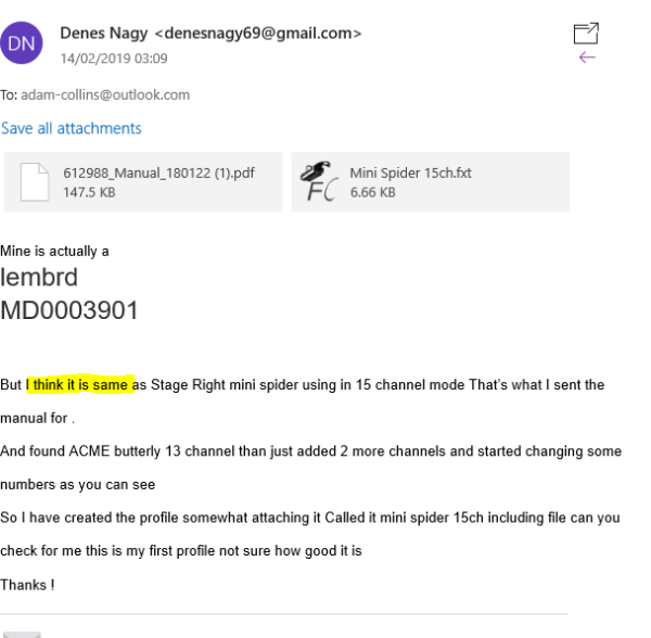

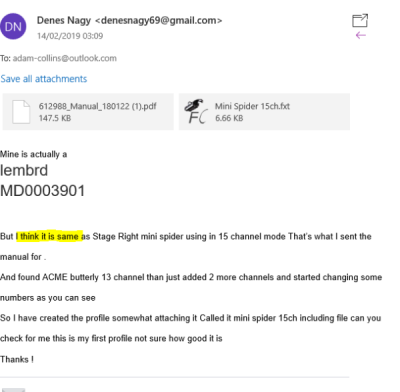

At first he said this,
I cannot 'test' fixtures if you cant provide the manual and are only assuming other manuals are working...
I sent him this in reply he still didn't get it and he's a fucking idiot
so he's now banned!
