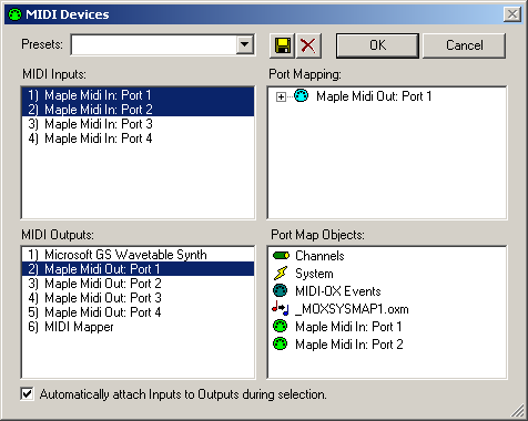

> open MIDIOX
> open the midi device window
> select the two korgs as input (in picture I used virtual input, because I don't have the korg's to show it with)
> select midi output (midi yoke or maple virtual midi)
> In Freestyler use the virtual midi as input.
I don't know how midiox handles the same note from different channels/controllers, when mapping to one channel. maybe you have to map this manually by using the midi data mapping feature in MIDIOX.
I have never tried it my self so please, give some feedback
