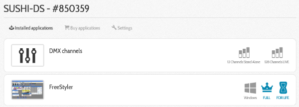

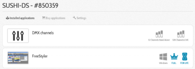

Snowyslopes
Re: Unofficial supported DMX interfaces
Hi Guys,
I'm a newbie here and also to DMX software.
I have some generic Chinese 7ch LED PAR lights and a Chauvet Obey40 hardware controller that works fine.
So I thought I'd try software and I bought a SUSHI-DS USB adapter. Having a search on here it seems that it's not supported. However, Support Website for the SUSHI-DS has an option to install an update to the dongle for FreeStyler which I've installed. Problem now is I don't know which interface to specify in FreeStyler to make it work.
Any ideas anyone? and is it supported or not?
Thanks in advance
Thanks in advance
- djSupport
- Posts: 1916
- Joined: 09 Jul 2007, 18:57
Any un-listed dmx devices may use the Enttec OPEN DMX, open source drivers or the pro version so if anyone has the same issue as above by Snowyslopes always try that first
