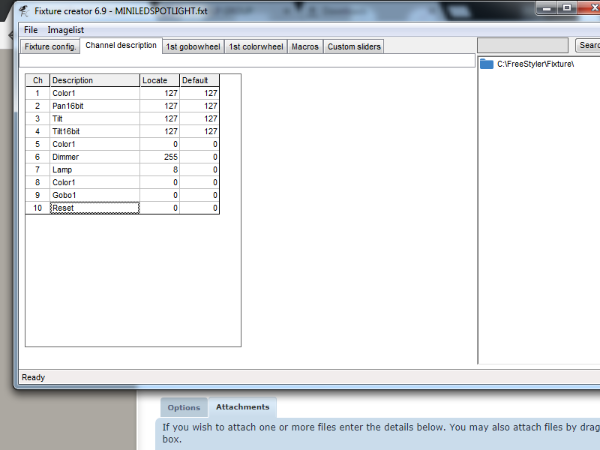

Hi,
I am new to this forum so if anyone looking to buy these decent EBAY (MADE IN CHINA) LED moving head lights from this link and I made basic tutorial to install your Fixture into direct files.
U'King 30W LED Moving Head Lights
http://www.ebay.com/itm/311673188409?_t ... EBIDX%3AIT
All you have to do is DOWNLOAD, COPY & PASTE all the files over your directory of Freestyler
FOR EXAMPLE:
D:\FreeStyler
MINILEDSPOTLIGHT.rar
U'King 30W LED MOVING HEAD LIGHT
(30.02 KiB) Downloaded 688 times
:fs:
MINILEDSPOTLIGHT.pff
(102.46 KiB) Downloaded 849 times

Please use the export function in Fixture Creator and upload the pff file.
This is the proper way to upload a file.

I would provide just the PFF files but there also images of GOBO and COLOURS on their own that i created with photoshop files of image for the fixture.
Jan_K
Pro Supporter! (Moderator)
Posts: 1155
Joined: 04 Jan 2011, 21:57
FreeStyler Version: Beta
Re: UKing 30W Moving Head Light [FIXED]
Post by Jan_K »
If you use the export, pff file, then it is all packed into one file and the import will place images, gobos and so on, in the folders.
pff contain a complete fixtures with images.
ljst0027
Post by ljst0027 »
Thanks, I am new to this lol
(102.46 KiB) Downloaded 521 times

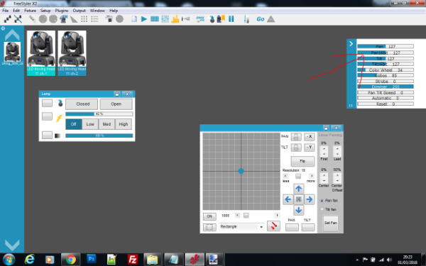

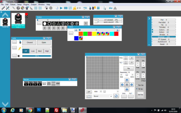

thanks for youre help , im new to this dmx world just struggling at the moment , but im not sure where i will find the dmx values
when i click on the panel on the right then it changes , just no panels come up obviously because its not setup
sowdenssounds
Posts: 5
Joined: 25 Feb 2018, 21:12
FreeStyler Version: 2
Post by sowdenssounds »

No worries. We are had to start from zero.
The window in the bottom right of your picture is the Pan/Tilt window. [FYI, on the bottom left of this window you can access the pre-programmed Freestyler movements].
The Lamp window will control your dimmer and strobe channels.
These windows are provided to make controlling your lights easier. They do the same thing as the standard sliders in the upper right hand corner [except they may add additional programming function such as the Pan / Tilt movements]. Either may be used.
One way to open the extra windows is to click the top menu item Window and then click All. Until the fixture definition is updated no other windows are available.
Finding the DMX values is easy if they are in the manual. If not..... get a pencil and a piece of paper:
Use the dimmer to bring the light intensity up to a level you can easily see
Color Wheel: move the standard slider for the Color Wheel slowly from left to right. The color of the light should change. With each change in color note the color and the DMX value show in the right hand side of the color slider.
Gobos: move the standard slider for the Gobosl slowly from left to right. The gobo should change. With each change in gobo note the gobo (just number them from 1 to ... if you do not want to draw the gobo image) and the DMX value show in the right hand side of the gobo slider.
Pan Tilt speed: there is no other window for this. You will need to experiment with the speed until you develop a "feel" for what you like. This may vary depending on your light show.
Automatic: I assume your instrument has some pre-programmed shows or movements. Without the manual I am only guessing. Again, move the standard slider from left to right and observe the effects and DMX value. Be aware that this channel may work in conjunction with others. Without the manual ....
Best wishes! Please post updates to your progress.

thanks for all you're help so far , ive managed to digg around google for similar fixtures to mine and fount one
and just copied some settings other fixtures that did work , i think its working ok now
just got to see if all works with making the sequences next
thanks again
