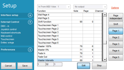

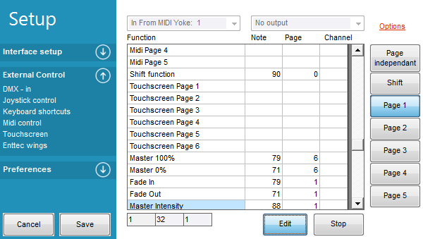

discodave wrote:...there's one thing I don't understand. How did you create the 'shift' button in your configuration?
I think I figured this out from looking at FreeStyler's setup, see screenshot attached.
There's a "Shift Function" command, which is set to the button in this config, then some of the other commands have page set to 6 instead of 1. When you hold down the shift button now it seems to set the input to page 6.
I found this because I thought I was setting my new buttons by holding the shift button when in MIDI edit, but I wasn't - I was just overwriting with page 1.
You have to click the "Shift" button on the right side of the assignments and then press your button on the controller normally (don't press the button programmed as shift or it will get reassigned).
Then when you're finished, change the button in FreeStyler back to Page 1.
