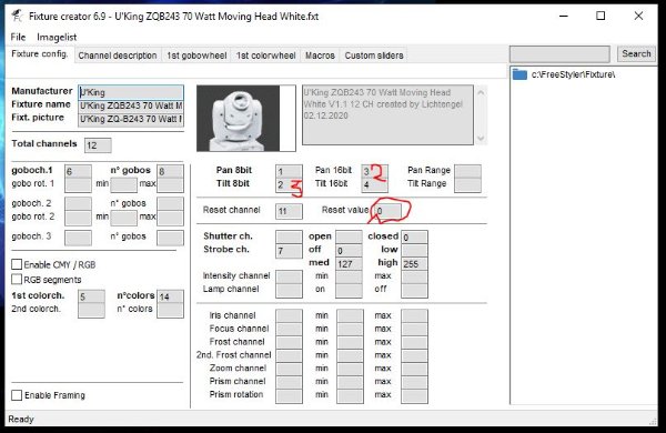

Hi,
I start to create a completly folder with pictures, manual and fixture. It's my first time.
But I think there is a Probleme. The Global ID for the collors are not enough. Because the moving head have half/half colors and not a 2nd colorwheel.
Maybe there are more errors(macros what ever?). My brain stoping now. If some one can check this, I'm pleased.
Cheers yours Lichtengel

Re: U'King ZQ-B243 70 Watt Moving Head White
Hej
It looks fine and I have some minor comments.
To me it looks like you have swapped channel 2 and 3.
Regarding Global color ID's
You are only to have the numbers once in your color table. If you you have the same number twice then Freestyler don't which one to use. (I can see that you have 1 twice)
Also don't use the id's on half colors.
I can see in the data sheet that there are a color shift channel 5, 140 to 255.
If you want to add this to you color table then it can be done by adding 3 rainbow icons with the values
fast = 140, med = 198, slow = 255.
On the Gobo I can see that you can add some shaking and shifting functionality.
I think if you look at the mac250 moving head then it may give you an idea of how to implement this.
On the reset channel, Channel 11 you are to enter the value 255
And on the macro tab you have channel 9 = 255 ? That is the speed channel, any special use ?
Hi,
thanks to Jan_K
I modificated the fixture and I hope it's now correct. Please check it.
I tested the fixture and it works for me. I also sorted the gobos in the correct order.
Only I don't now how can I use the half colors, because there is no ID to push the collorbutton later inside freestyler.
Cheers Lichtengel
thanks to Jan_K
Cheers Lichtengel
- Posts: 1155
- Joined: January 4th, 2011, 9:57 pm
- FreeStyler Version: Beta
Have a look under "Setup" -> "Use global colors"
If this one is checked "on" then change it to unchecked.
If "on" only colors which are global defined are shown. This is useful if you use more fixtures of different types. If you select a red with more different fixtures selected then the color with ID = 10 will be selected on all of them and in this case 10 is red.
