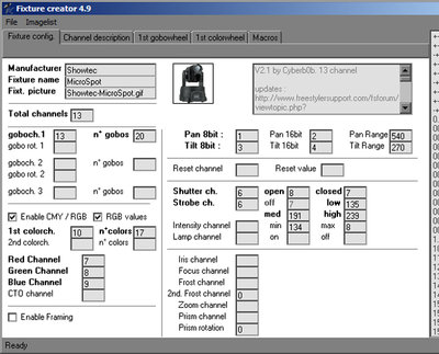

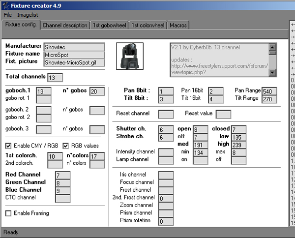

I am developing a fixture for the showtec microspot LED 13 ch.
But i run in to throuble.
The fixture can be found in this topic : http://www.freestylersupport.com/fsforu ... 7118#p7118
The problem that i have is with the master intensity (dimming/fade in/fade/out).
@ the moment, the master/submaster intensity works for the rgb colors (those are 3 seperate channels) . But doesn't work on the color wheel.
If i put a 6 in the intensity channel, the whole master intensity does not work anymore.
Anyone got suggestions to get the master brightnes working on as wel the color wheel and the RGB Color channels?
Best reg,
Bob

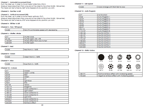

Attached the overview of the showtec microspot led dmx settings.

In addition, There is no real color wheel in the microspot.
Those are led value's on a different channel, which they call a color wheel

I don't think there is anything to do with your issue. the microspot dont have an intensity feature for the colour wheel. Freestyler cant help you with that. And i can't find any workaround to shut off the beam when you set the master or submaster intensity to zero. the best way is not to use the "colour wheel" (colour macro) channel.

I have checked it with the sliders @ the right side of the screen.
If i select a "color wheel" color. I can control "with a part of channel 6" the intensity of my color wheel.
