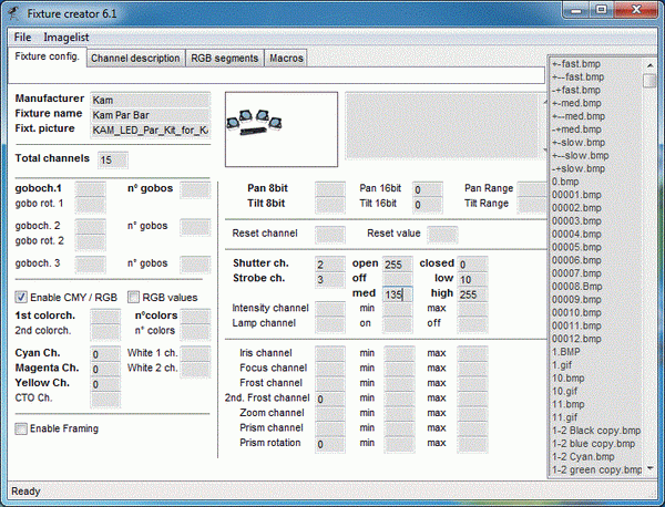

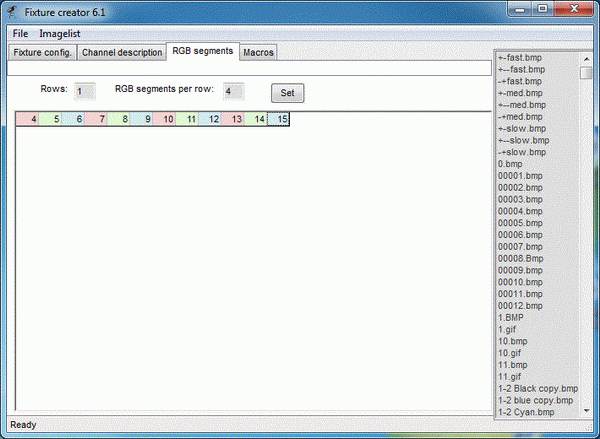

Have had a look on your fixture and have some comments.
You have not filled in many parameters in the Configuration panel
To controll all the RGB channels I would use RGB Segments.
And finally make the program control in the Macro.
Have eventually a look in the Wiki there everything should be described.

It is more like this one just you don't have the white conrtol.
http://www.freestylersupport.com/wiki/f ... can:arc2_s
And as you detected then in my screen dump there are the values entered.
Just want you to do the changes your self so you learn a bit. :D
