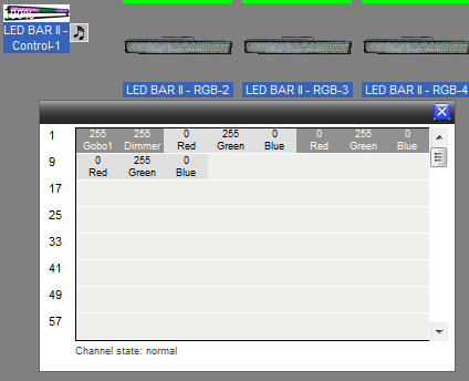

mcbda
Re: Fixture File Help for a Miroh LED Bar 2
Ok I've attached the screen dump. Channels 1 (effect/gobo) and 2 (dimmer) are the controls and channels 3 through 11 are the RGB sliders. The RGB sliders work perfectly however with the current values that are being displayed (255), the lights should be sound strobing and instead they are just doing a fast chase.
Could freestyler be passing the wrong values to the light?
Thanks,
Matt
Thanks,
Matt
Jan_K
- Posts: 1155
- Joined: 04 Jan 2011, 21:57
- FreeStyler Version: Beta
To me you have the correct setting for sound controlled strobing.
The value you see in this output window is the actual DMX values at the channel.
If you know anyone with a hw controler then you can try connecting it to that one and see if it works there.
Then you have tried all possibilities.
I think you should contact "microhpro" and and ask them what is wrong.
Send them the screen dump so they can see that the setting is correct.
