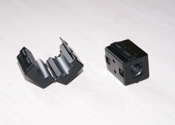

and another option that I used that might also make it more stable.
the use of a Ferrite core clip on on the USB cable that go into the DMX controller.
It's general use is to filter out spikes that can cause sensitive hardware to freeze or none respond, the spikes can occur from for example, a air-conditioner or a messed up power switch and so on....., so assume it's a low level EMP pulse that get's released from certain appliances
look in my attach files for example, of what I used
