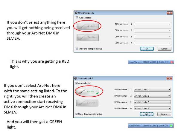

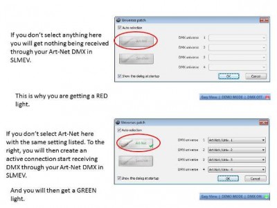

Can somebody post the windows 7 fix
Sent from my iPhone using Tapatalk
- buttza
- FS is my life
- Posts: 351
- Joined: 07 Jan 2010, 14:14
- FreeStyler Version: 3.6.4
Re: Freestyler not communicating with Magic 3d Easy View
See image
