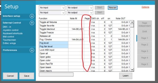

the next column over in the midi programmer is "page". You can usually change button colors and on/off status of leds with the ON and OFF columns (values vary depending on controller)

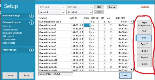

simply put the first 32 on page 1 and the final one on page 2. when programming, map the first 32 as normal to page 1 then on far right of window select page 2 and map button 1 to whatever you want on your midi controller

This doesn't seem to work :(
The first 32 mappings work correctly but the next ones simply dont work.
Even if you just want to map a single button to page 2, that midi button will not activate the button on the second page :,( try it please as I might be doing something wrong.
I've been using freestyler for years and making small setups, this is the bigger one and this is the only bottleneck I found so far for what I need. HELP :(

Anyway, if you try to do that, you'll see that when you map the second page, the software automatically clears the mapping for the first page.

The only way for this to work is to select "Page independent" and then map other buttons to change the pages. But again, I'll be using 2 clicks for something that I wanted to use just one. I think you walready understand what I need.
