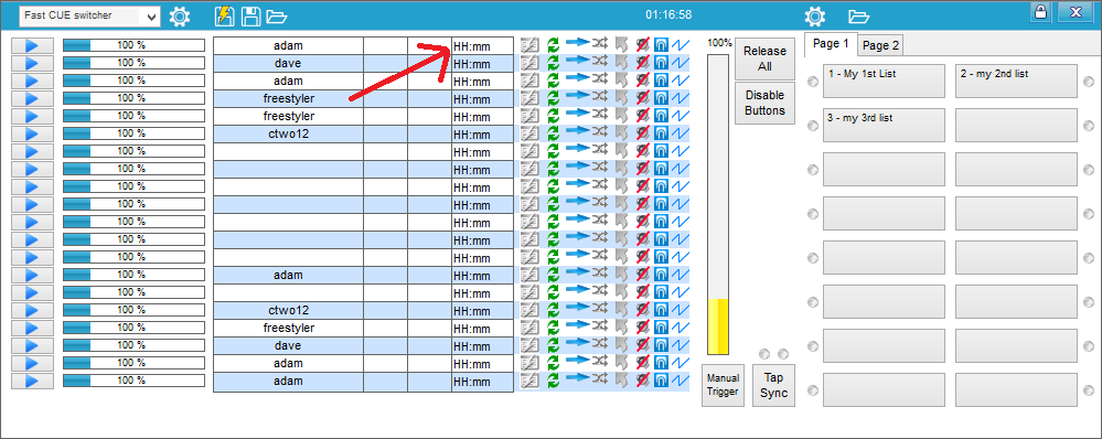

Many thanks both. I may try the 2nd option later, but to get me started, where do I find the basic PC clock scheduler?

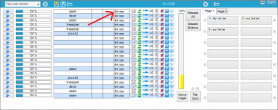

HH = hour MM = minutes

Cheers! I'd seen that page but never realised the significance - doh... I will have a go and let you know how I get on. :D

OK, an update... I've worked out how to add a sequence to the cue list and time schedule it according to the PC clock, and it works a treat thanks.
However, I am having some difficulty getting it to do what I want it to. Here's a typical scenario:
I want all the fixtures off for most of the day, then to go red for 5 minutes at 17.00. I assume I should therefore set a cue timed for 17.00 to turn them all red, then set a second cue timed for 17.05 to turn all the fixtures off? Individually those 2 sequences work fine, but when I add them to the cue page the off command seems to overrode the on command, so I get nothing. I'm probably going about it the wrong way, but I'd be grateful if someone could explain how I should do it. Thanks
