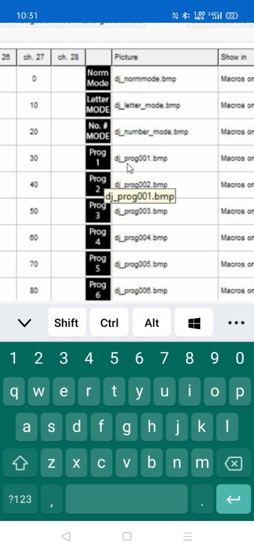

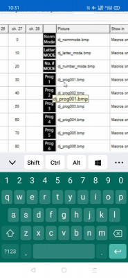

Create a little picture describing what the function does for example I have one button that says "func off" which means it sets that channel to 0 then create buttons like "10 Ch
Mode"
Add all these on the macro window it then gives you a bank of options to choose...
You can use any paint program, open up existing ones in the gobo directory for the correct size and save as a .BMP
Save it back in the gobo directory then use them in the macros function.

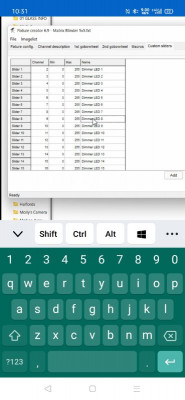

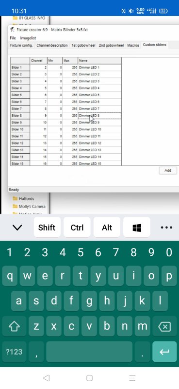

A similar light to yours, notice how I've put the functions options in the macro window
Any other dimmer beyond the master dimmer is on the custom sliders menu, this gives me full control over every single light.
If your fixture has a few options for how many channels it uses make sure the 'total channels' has the maximum number the light use that way no matter what option you select with your macro buttons it will never interfer with other lights
