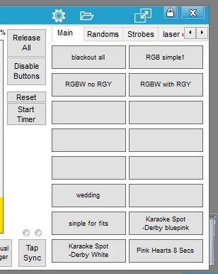

Also, use keyboard shortcuts/midi cues to assign buttons to things you do a lot, like start/stop cues.

you can use keyboard or midi control to trigger your show, i use manual triggers on midi controllers for submasters and cues and overrides and have color bumps and fog on keyboard
Depending on the size of the rig and channel and options each light has, i would leave submasters to single attributes... they then become cue building stepping stones!

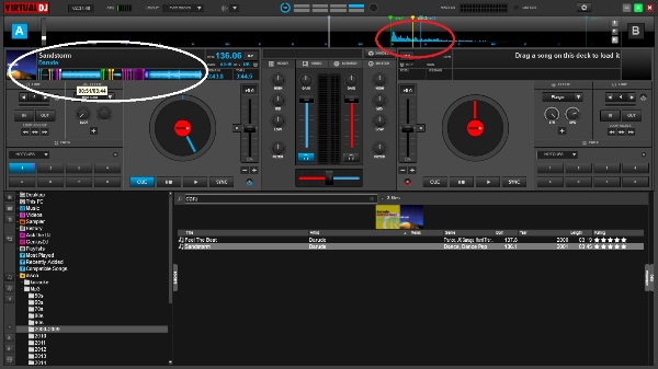

I use mine with Virtual DJ 8 Pro and use the cue points which react a set programmed light setup
each line is a pre programmed sequence
which looks like this
set $fsvalue 255 & set $fscommand 267 & set $fsvalue2 255 & set $fscommand2 273
as you can see I have setup for all songs (provided I have pre programmed it)
