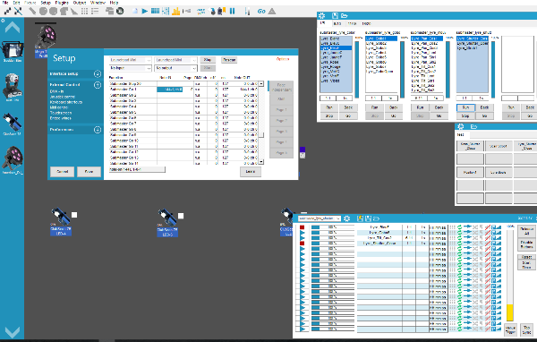

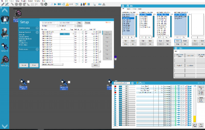

I have a "Novation Launchpad Mini" to control Freestyler with the MIDI controler.
I can run a submaster by assign the function "Submaster Toggle 1" a button of the lunchpad, it's ok.
How I can assign a sequence of my submaster to one pad of the lunchpad ? I can only assign "Submaster Go 1" and "Submaster Back1" to change the sequence in the submaster. Even if I do it, I have to "Stop" and "Go" the submaster to applies the modification in the current cuelist.
Is it the normal running ?
I send you a screenshot of my configuration.
Thanks for your help.
Thanks for your answer.
I didn't know how we could use Submasters. I tested and my first problem is solved, I can launch many sequences in the same time
I created a cuelist for each function of my machine (color, gobo, movment, shutter...). Next I loaded the cuelist in each submaster. When I select my sequence in the submaster and I click on "Run", it works and I can lunch different submaster in same time.
But I have still a problem with external control !
