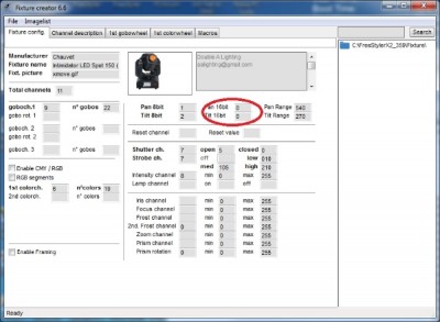

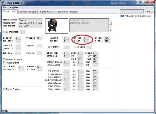

I just had a look in the fixture file.
The Pan and Tilt 16 bit is set to 0 should be channel 3 and 4.
This should how ever not be the problem but change them as I don't know what FS does with a channel 0 definition.

I did has you said for the pan and tilt also yesterday after I read up on what 8 bit and 16 bit meant 16 bit is for fine tilt and fine pan

Have you updated the fixture file.
Changed Pan 16 bit to channel 3 and Tilt 16 bit to channel 4.
If so and it still don't work then you can try this fixture.
There is nothing to it only 11 sliders it must work.
You shall be able to see changes on the output monitor with that one.

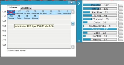

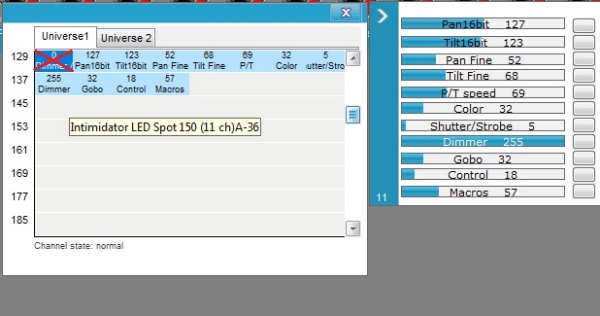

I just made a images of the output monitor of the fixture you uploaded.
It works on all the fixture control panels and the Right side sliders.
As you can see the value on the slider and output monitor are the same.
