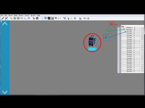

I am using led cans purchased off of ebay, they are the 188 lamp led with the dip switches.
Does anyone have a file made for these? I don't have a brand name.
Thanks in advance
Needing help with creating my lights

Did you try Mode 3, that is usually a 3 Channel RGB Mode.
Don't know for sure but usually with most LED Pars that is the the standard 3 Channel Config. Then you can use a generic RGB Fixture profile.
Only thing with this option you can't control Fixture intensity. Only colour intensity. If you want to control the other options then you will need to test it.
If you load in a 12 channel dimmer then you should be able to control each aspect of each mode using the sliders.
Also there are plenty of great dip switch apps available for free.

Hi
It's difficult to create fixture files unless there's a manual for them, the best way otherwise is like buttza said.
Regards
Nathan
