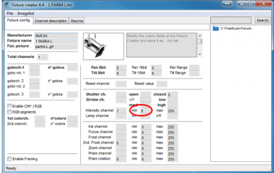

You can do that by using the fixture creator.
Open the FS Fixture Creator
PAR64 Folder
Open 1 PAR64L
Then in the intensity channel change Min value from 0 to 48.
Save file as Custom PAR64 or other name you wish.
That should help.

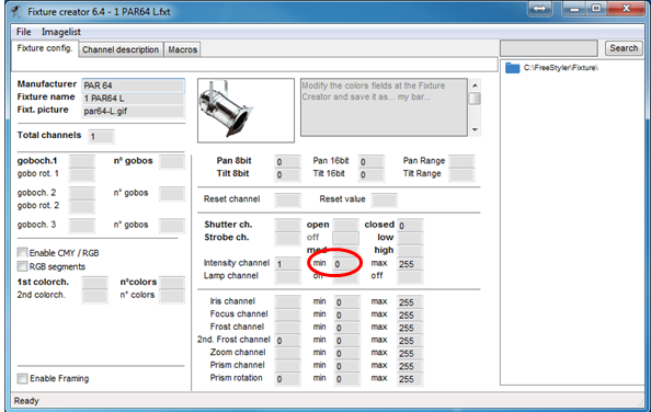

PAR64 Folder
Open 1 PAR64L
That should help.
- Posts: 5
- Joined: October 26th, 2013, 7:17 pm
- FreeStyler Version: 3.5.4
- Twitter: @webnerdnick
Re: Minimum intensity for dimmer?
If I already have the fixture added to a layout will I have remove and add it again? I already tried the suggestion but it didn't seem to make a difference.
- Posts: 1155
- Joined: January 4th, 2011, 9:57 pm
- FreeStyler Version: Beta
If you use the faders / sliders in right side of FreeStyler and not the lamp control panel then it will have no effect.
The faders in the right side panel always goes from 0 to 255.
The ones in the panels can be limited as buttza shows.
Else have a look in the output monitor panel to see what FreeStyler sends.
