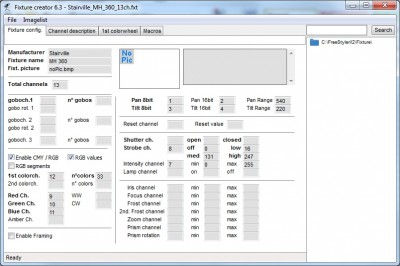

I started but I'm lost, here is a screenshot of the current configuration:

Hej
You are a bit off but lets take it in small steps.
First updat to the latest version of FreeStyler. Your Fixture Creator is an old version 6.1
"Pan 8bit" channel 1, "Pan 16Bit" channel 2, and "Pan range" 540.
"Tilt 8bit" channel 3, "Tilt 16bit" channel 4, and "Tilt range" 220.
Remove channel 6 from "shutter ch"
Strobe "Off" = 0, min = 16, max = 247 and add a med value.
remove the lamp value 110 and 255
Change "Color Wheel 1" to 12.
This is just for a start.

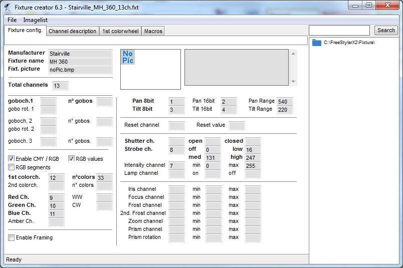

lumpy26
Posts: 2
Joined: April 3rd, 2013, 8:47 am
FreeStyler Version: 3.4.4
Re: How to create fixture for Starville MH-360 ?
Post by lumpy26 »
Hi,
Thank you for your help, i just update Freestyler and add your value, check the screenshot :
But i can't save the fixture, when a save a windows error say : "Please fill in all Color values"

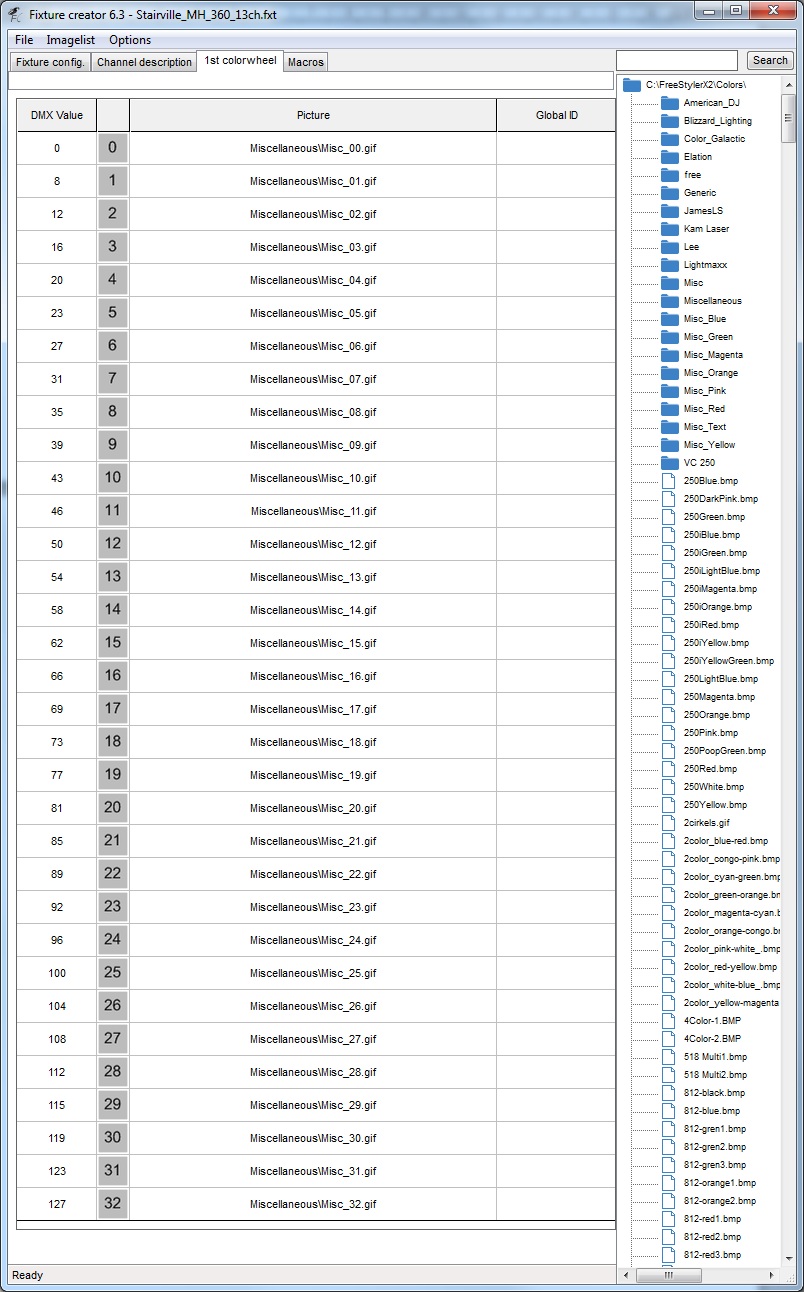

You have not changed 1st. color wheel from 9 to 12.
And you have to fill in the values on the color wheel tab.
And intensity min = 0 and max 255.
Have a look on the wiki. there are a lot of exampels on how to create fixture.

Have a look
I have not entered all the chase values in the color wheel and as I don't know the colors I have just given the colors a number icon.
Also the values may need to be adjusted.
